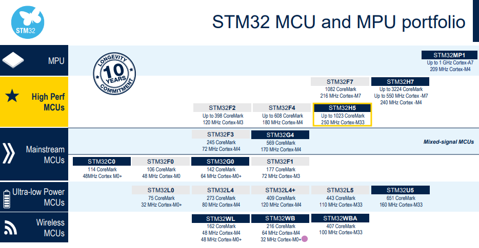

The STM32H5 comes to complete the STM32F4 not STM32H7 , STM32G4...
So , If you have a look on the portfolio you can find the STM32H5 after the STM32F4.

The new STM32H5 series comes to complete the STM32 High Performance MCUs portfolio.
It comes to complete the F4 series.
For more details, you can check the Product Presentation : STM32H5 MCU series Most powerful Arm® Cortex®-M33 MCU yet

Thank you Foued. But my question is, why H5 clock rate is lower than H7. Is it a limitation of CM33 core vs. CM7, or has other reasons?
Users definitely like high performance figures. Even if they don't actually need or utilize it, potential to scale up looks good.
