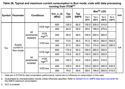

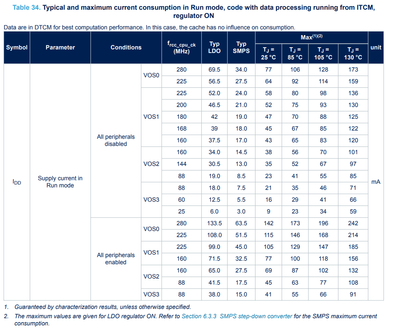

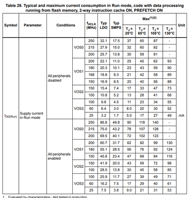

2025-06-16 5:59 AM
Hello @etheory
Which frequency are you looking for with Hexadeca SPI? For high speed its rarely seen on mainstream and entry-high performance MUCs.
For sure the H7RS is not create for battery powered devices. H7R3 in VOS LOW with core freq at 300/400MHz, would still consume more than the H5 comparing all peripherals ON in Run mode. But we do see some applications where the MCU is not the main consumer of the battery. for example in Thermostats or Ebikes etc, which sometimes with on larger displays/resolutions.
