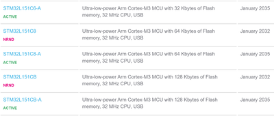

Some STM32L151 chips are already NRND. If it's one of those, no. The ones that are still active have a 10 year product commitment. Typically, this gets pushed out yearly but there's no guarantees past 10 years. At the very least, you'll get a 9-year heads up that the chip may be going away if you check the list yearly.
Partial list here:
You can read more about it here:

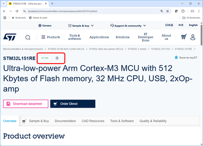

When you go to the Product Page for the specific part, you will see the status, and lifetime promise ("longevity"); eg,

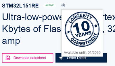

Hover over the longevity badge for further details:
Click it for more.

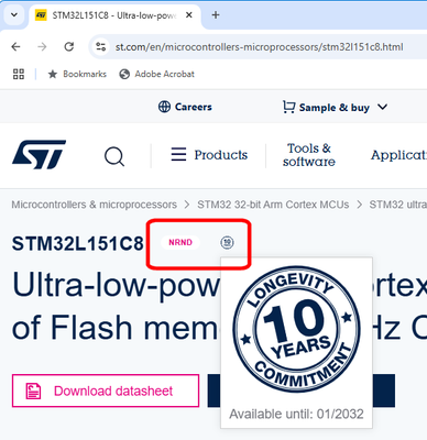

As @TDK said, some are already NRND:
