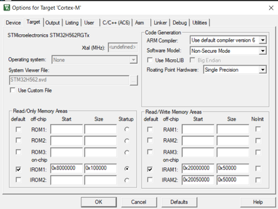

2024-11-11 6:44 AM - edited 2024-11-11 6:45 AM
Hi @Tesla DeLorean ,
I have attempted to use the template folder.
Following are some configuration:
struct FlashDevice const FlashDevice = {
FLASH_DRV_VERS, // Driver Version, do not modify!
"STM32H56x MX25L6433F", // Device Name
EXTSPI, // Device Type
0x90000000, // Device Start Address
0x00800000, // Device Size in Bytes (8MB)
256, // Programming Page Size
0, // Reserved, must be 0
0xFF, // Initial Content of Erased Memory
100, // Program Page Timeout 100 mSec
3000, // Erase Sector Timeout 3000 mSec
// Specify Size and Address of Sectors
0x001000, 0x000000, // Sector Size 4kB (2048 Sectors)
SECTOR_END
Not sure if the following settings are correct:

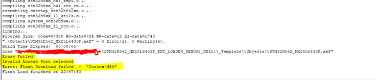

I have been facing an issue with the external loader i have generated.
My application is writing to 0x90000000 address the following data:
const unsigned int delay_data[4] __attribute__((used)) = {0x01,0x02,0x03,0x04};
During download i get the following error:

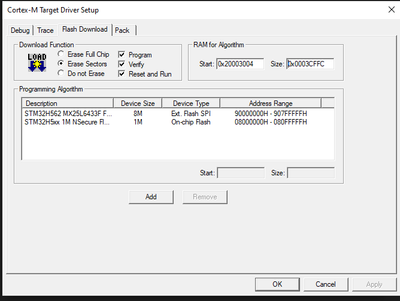

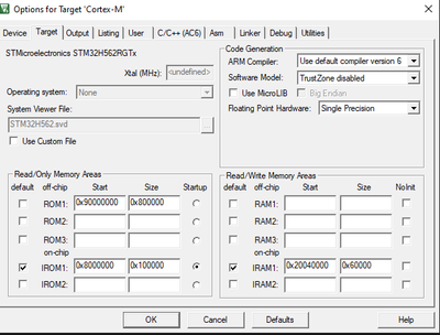

Should the start address of the algorithm be 0x20003004(used in cubeIDE) or 0x20000000? Also should the Vector table address be modified?
Following the my configuration:
I have tried to increase the size of the algorithm but i had the same error.
Do you know what may causing this issue?
Thank you.
2024-11-13 7:04 AM
Changing the optimisation from 0 to 2 in my external loader project fixed the "Invalid access port" issue.
As for the start address of the algorithm i have tried both 0x20003004 and 0x20000000. Both cases i was able to write to external flash successfully.
