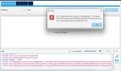

I’m working with a custom board featuring the STM32H725ZGT6, and I’m encountering some issues I hope you can help with. Out of the 10 boards I've assembled, 7 are functioning perfectly. However, on a few boards, the MCU isn’t being detected in STM32Cube Programmer. When it does get detected, I receive the following error (screenshots attached).
To troubleshoot, I’ve attempted the following:
Has anyone experienced similar issues or have suggestions on what might be causing this inconsistency? Any guidance would be greatly appreciated!

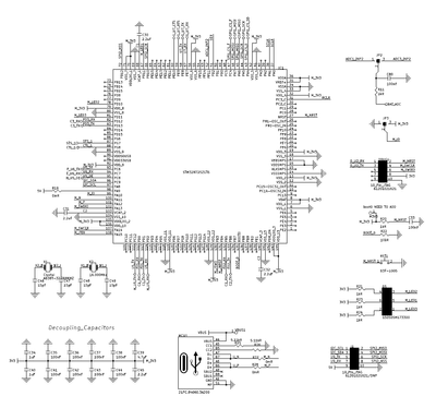

here is my design
I'm sharing my board schematic here for reference, as I’m facing a few puzzling issues with my custom board based on the STM32H725ZGT6.

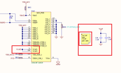

I’ve attached my schematic above, and I’d like to share some VCAP voltage readings in case it helps diagnose the issues I’m experiencing:
I’ve replaced this capacitor twice, but the issue persists.
Is this behavior expected, or could it be pointing to an underlying issue? Any insights would be greatly appreciated

i see some problems :
- Why you choose a chip with smps on-chip, but dont use it at all ??
- vcap pins connected not correct :
- what is on VDD33USB ?
- whats on PDR_ON , pin 142 ?
2024-11-13 5:17 AM
- VDD33USB - 0V
- PDR_ON, pin 142 = 0.2V
2024-11-13 6:39 AM - edited 2024-11-13 6:41 AM
So you have to:
- connect VCAP pins
- connect PDR_ON, pin 142 to -> VDD
- connect VDD33USB to -> VDD
after connecting these, without power, check with DMM : VDD (3v3) --- GND has no low impedance (short)
