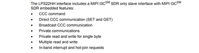

For the LPS22HH, you can check the datasheet to check the supported features ( DS : Datasheet - LPS22HH - High-performance MEMS nano pressure sensor: 260-1260 hPa absolute digital output barometer )
Please check 7.4 MIPI I3CSM slave interface section .
Foued

Hi @Foued_KH ,thank you for the reply, but based on the feature showed in datasheet
I don't known what's the current I3C version included in LPS22HH sensor.
I get the DCR form LPS22HH value is 0x00, the BCR and TPID value all matched the datasheet except the DCR, and the waveform as follow:
and according to the DCR table (details table in MIPI : https://www.mipi.org/MIPI_I3C_device_characteristics_register), all version1.0 device DCR is 0x00. I doubt the version of lps22hh, so could you please help me analyze the issue?
