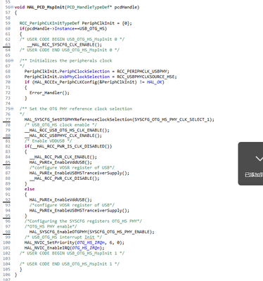

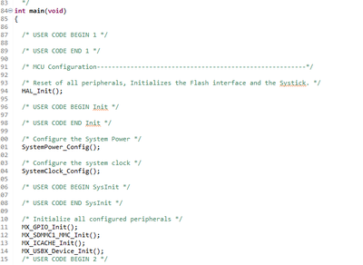

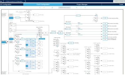

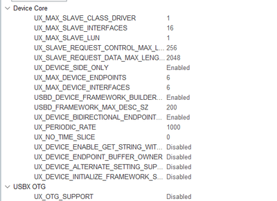

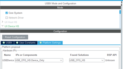

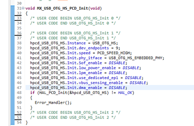

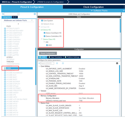

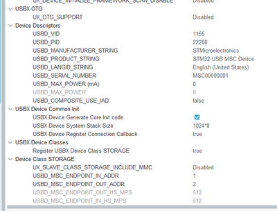

I am also using this board and STM32Cube_FW_U5_V1.8.0 to create a USBX stand-alone (without THREADX) MSC device,but struggling to get the board to enumerate with the PC.
I'm not sure if it's a configuration issue or a code modification problem.
Below are my configurations and code modification points.
Could you please help analyze them? Thank you very much!
configurations:
USB_OGT_HS:
NVIC:
RCC:
SYS:
USBX:

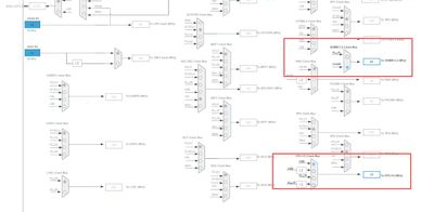

clock tree:

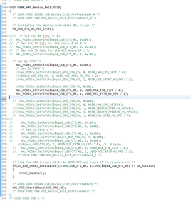

code:
UINT MX_USBX_Device_Init(VOID)
//default code
/* USER CODE BEGIN MX_USBX_Device_Init1 */
USBX_APP_Device_Init();
/* USER CODE END MX_USBX_Device_Init1 */
return ret;
USBX_APP_Device_Init:
MX_USB_OTG_HS_PCD_Init:
HAL_PCD_MspInit:
edit
related thread: Solved: STM32U5A9J-DK1 USB Device question - STMicroelectronics Community
2025-09-12 7:30 AM
Hello @tod
Here is working full setup for MSC standalone using USBX. It seems CubeMX is missing RCC clock configuration in HAL_PCD_MspInit()
__HAL_RCC_SYSCFG_CLK_ENABLE();

2025-09-12 7:30 AM
Hello @tod
2025-09-12 7:24 PM
Hi @FBL
Thanks a lot !!!!!
After making modifications based on your suggestions, the enumeration process now works correctly, and an empty drive letter (Removable Disk (H:)) is detected.
