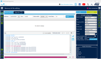

2025-02-27 2:56 AM
Sure, attached you can find both linker files.
Yes i tried both, commenting testing functions and setting the path of created linker.
Cubeprorgrammer returns the following error:
Do i need to flash a test.bin before start reading the first time?
Thanks so much
