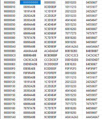

thanks, my configuration is similar as yours, it returns an error in the last check:
for(var = 0; var < SECTORS_COUNT; var++)
if(memcmp(buffer_test,(uint8_t*) (0x90000000 + var * MEMORY_SECTOR_SIZE),MEMORY_SECTOR_SIZE) != HAL_OK)
while(1); //breakpoint - error detected - otherwise QSPI works properly
Seems is not writing correctly data on the address 0x90000000

i think there are some dummy clocks in your configuration that are wrong, another guy in this forum have an issue similar to yours and resolve managing the dummy clocks
check the parameter
sCommand.DummyCyclesaccording to your memory datasheet

The Memory Mapped Mode just uses the same read command template as you can check in command mode.
You should be able to read in 1-bit and 2-bit modes to confirm actual content in the memory so you can determine "written wrong" vs "reading wrong"
