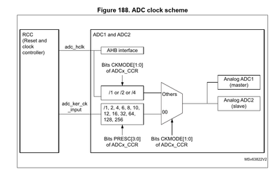

I think it's linked to this constraint on ADC clocks (from RM0481):
So you can't set different prescalers for different ADCs.
2024-04-12 9:31 AM
see from rm: clock/divider -> serving both ADC analog blocks
