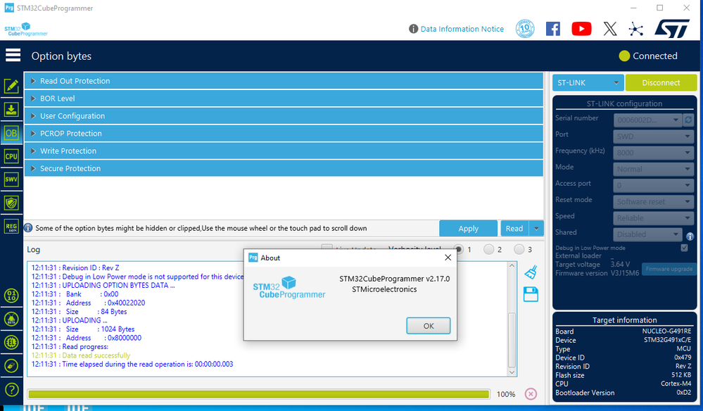

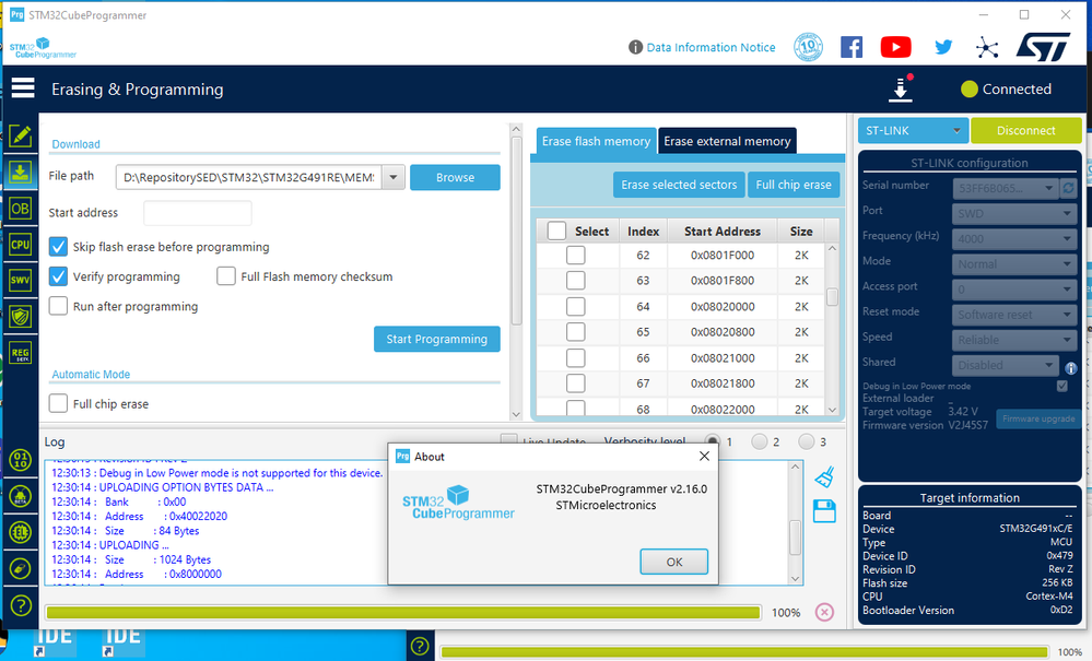

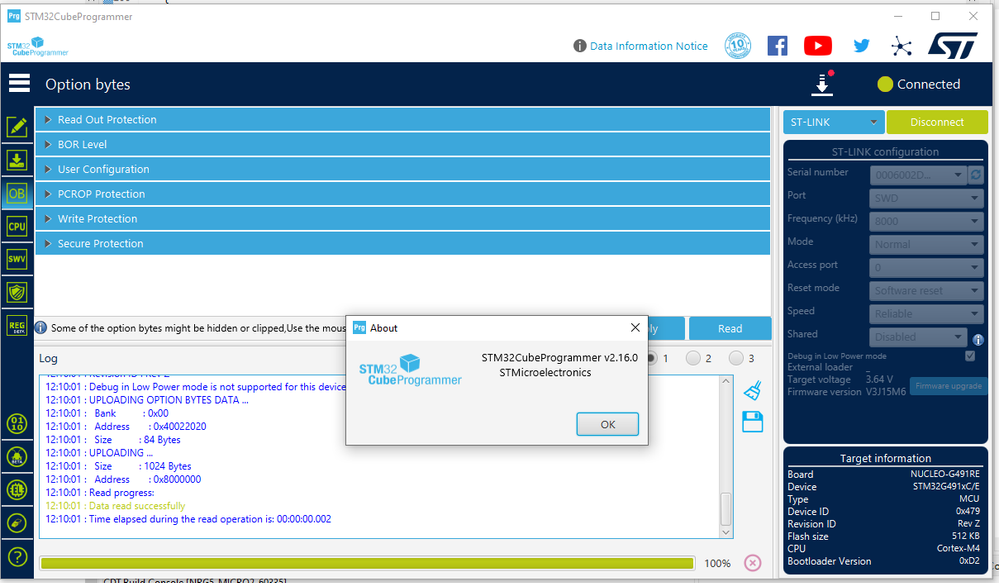

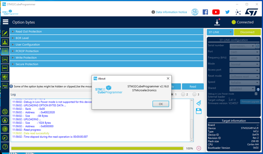

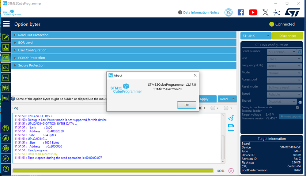

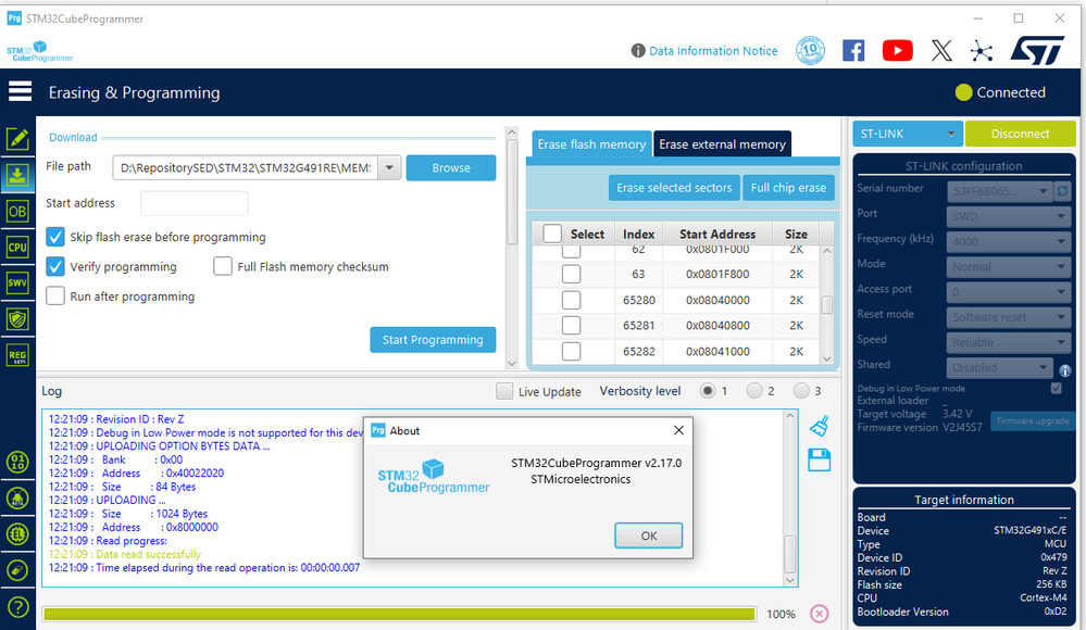

2024-07-17 3:35 AM
hello
sure. Here it is
I also noticed that with the previous version of the cubeprogrammer (2.16) the option bytes are shown
Even the display of the numbering and the address of the sectors to be deleted is different
Best regards
RCT6_CubePrg_2_16
RCT6_CubePrg_2_17
RET6_CubePrg_2_16
RET6_CubePrg_2_17
RCT6_CubePrg_2_16_Sector_erase
RCT6_CubePrg_2_17_Sector_erase
2024-07-17 7:32 AM
Thanks a lot for the screenshot. I raised an internal ticket to correct the issue:
Internal ticket number: 186818(This is an internal tracking number and is not accessible or usable by customers).
In the meantime you can still use the rev1.16.
