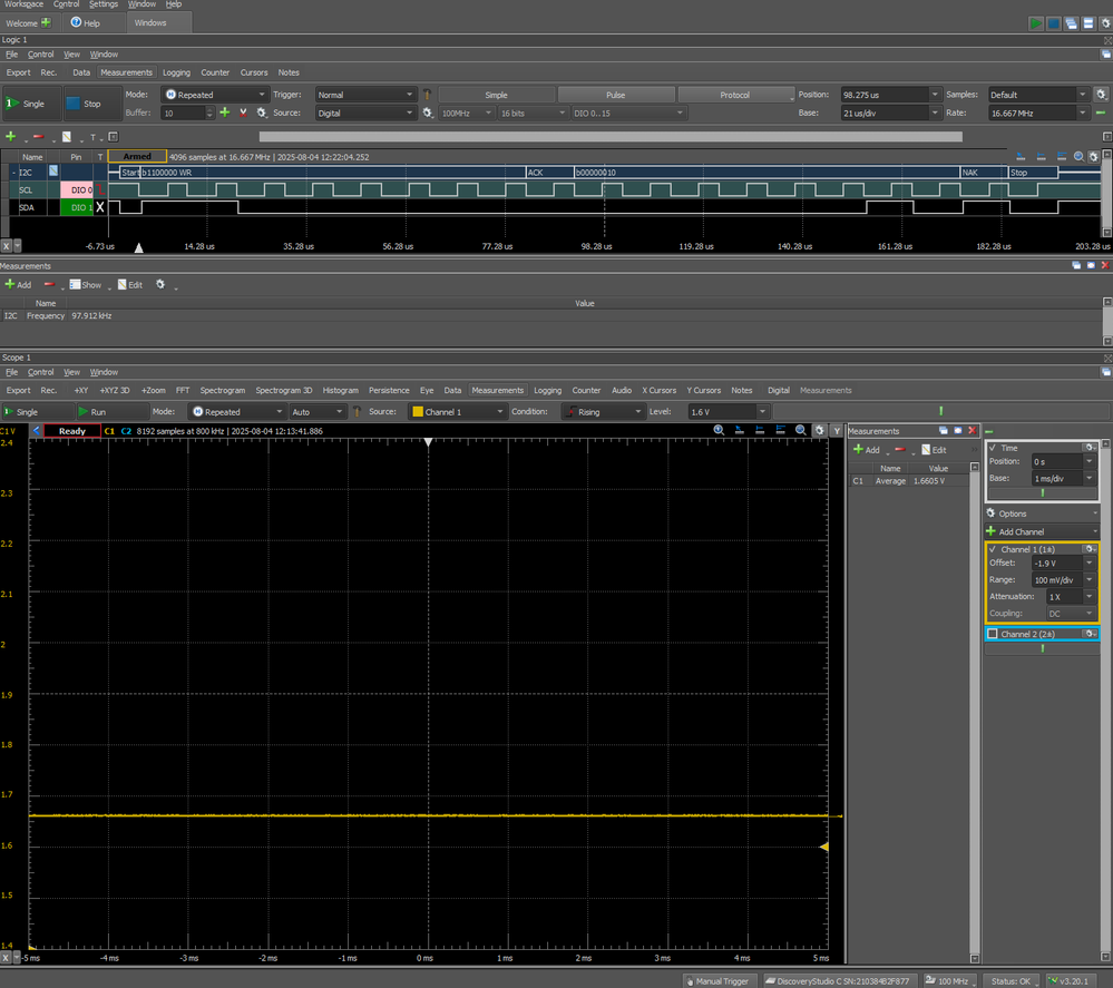

Okay I got the Logic Analyzer (LA) to give me a usable output.
However, STMCube is still reporting a HAL_ERORR.
The lower plot is the scope showing that the output of the DAC is reporting 1.6V, as opposed to the 1.3V the code is instructing it to output.
The LA does show that the 1st dataframe is correct as it is composed of the [start bit | Slave Address | Write Bit | ACK ] but then the rest seems to fall apart.

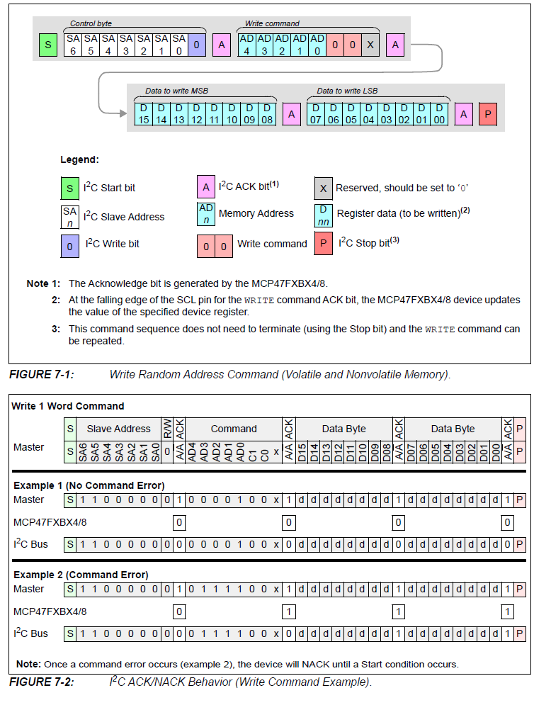

I haven't done a thorough look, but the way you store the "channel" value in your data[] array is not correct. The data sheet excerpt shows the "memory address" in the 5 upper bits, with the lower 3 bits == 0. You are outputting 0x02. It looks like the DAC is NAK-ing that byte, so perhaps that is the issue?

Below are the function call, function variables, and the LA
MCP47FEB18_SetVoltage(0, 1.3);
MCP47FEB18_SetVoltage(2, 1.3);
MCP47FEB18_SetVoltage(4, 3);Even so it does not look like it is causing the output of channel 4 to respond to the set voltages.
MCP47FEB18_SetVoltage(6, 1.3);
At this point I think that the mCU is behaving properly and I2C comms are up and running (excluding the oddity of channel 6).
On the target device side, as it is ACK'ing I want to say the I2C comms are being received correctly.
I am just not sure why it is not outputting the correct voltages.

Why are you shifting the channel number by 4 bits? Go back and look at the command format from your first post. That will explain why the voltages are not correct and why you get a NAK for channel 6.
2025-08-06 8:09 AM
Hi Bob S,
Keen eye on the channel bit shifting.
The ACK/NACK bit tripped me up a tad for the 2nd byte.
