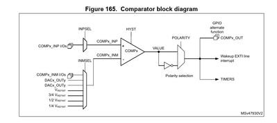

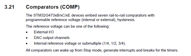

see in rm:
So internal DAC connection possible.

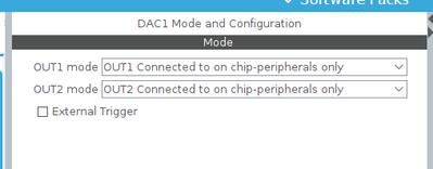

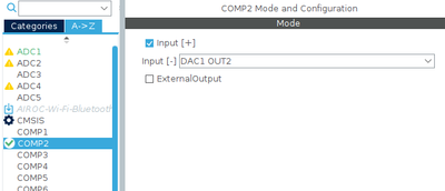

Just try in CubeMX , it shows , what you can select as internal connection.
example:
