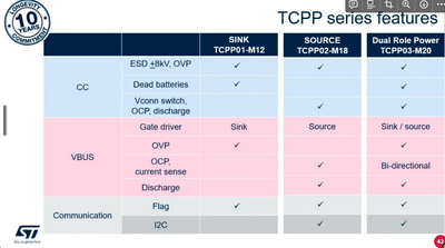

I am making a PPS (sink) application based on NucleoG0B1RE + SNK1M1. As noted in various resources, the TCPP01-M12 doesn't include OCP protection. However, the USB Power Delivery Specification R3.2 on usb.org, strongly recommends OCP protection for sink operating with PPS.

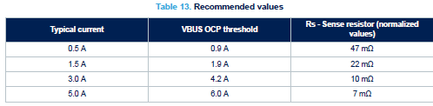

My thought was, that maximal current should never be reached so the OCP limit should be set slightly below 5A depending on the accuracy of sense amplifier. Yet looking into UM2891 it says that for nominal current of 5A, OCP treshold is set to 6A, why? Is this to account for inrush current spikes? If so how do I find the proper value for OCP, also with taking in account the sense amplifier accuracy?
Finally, I’ve read that the TCPP03 includes an OCP flag in its I2C register, and an OCP event can be handled via a recovery command from the MCU. Would it be feasible to use TCPP03 in place of TCPP01 for my design? If so, how accurate is the ISENSE feature of the TCPP03? Since I am also using some power for UI elements, and I want the user to know the actual current consumed by load (not the combined current: load+UI) I think that even when using TCPP03 I would still need two current measuring points, is this right?

Use TCPP03-M20 for SINK with OCP is the best path forward.

TCPP01-M12 has been tailored to optimize cost then it embeds only key protections for SINK (OVP on VBUS / CC + ESD).
When VBUS OCP is needed, TCPP03-M20 can perform SINK only solution with OCP feature. It is the recommended solution.
TCPP03-M20 embeds an OCP based on shunt resistor (Rs) voltage (OCP trigger = 47mV). The Rs value provides current threshold.
There is a margin between typical current on VBUS and OCP typical value to avoid parasitic OCP trigger (current margin, component margin, noise, …).
It’s a fixed OCP based on maximum current.

TCPP03-M20 can be used for SINK only solution.
