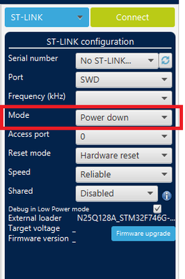

Second, with STM32CubeProgrammer tool, try to connect under "Power down" mode:
