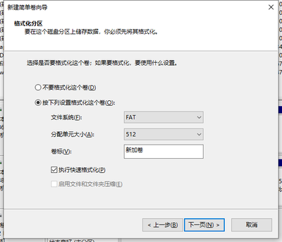

I can see an unallocated Disk 3 in Disk Management(3.64GB), but when trying to format it(FAT,size=512), I get the error: "The request could not be performed because of an I/O device error."
