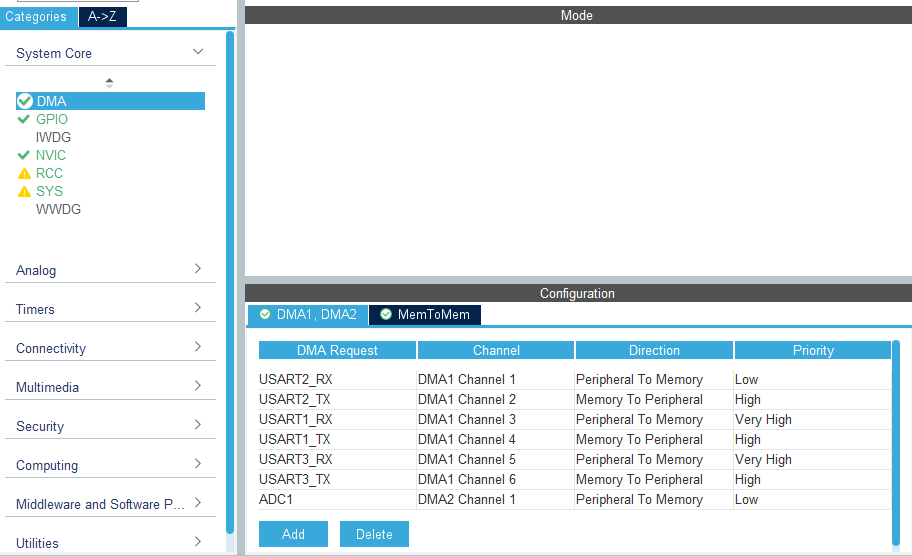

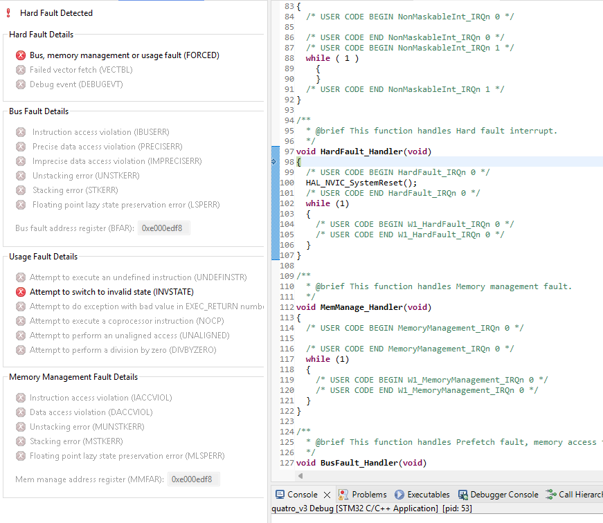

I'm using ADC with DMA in a large project, and faced some very strange problem:
If I'm using DMA2 Channel 6 - ADC works correctly
If I'm using DMA2 Channel 1 - the SW end up in Hard Fault
Screenshot 2025-10-07 125752.pngScreenshot 2025-10-07 125821.pngScreenshot 2025-10-07 124405.png

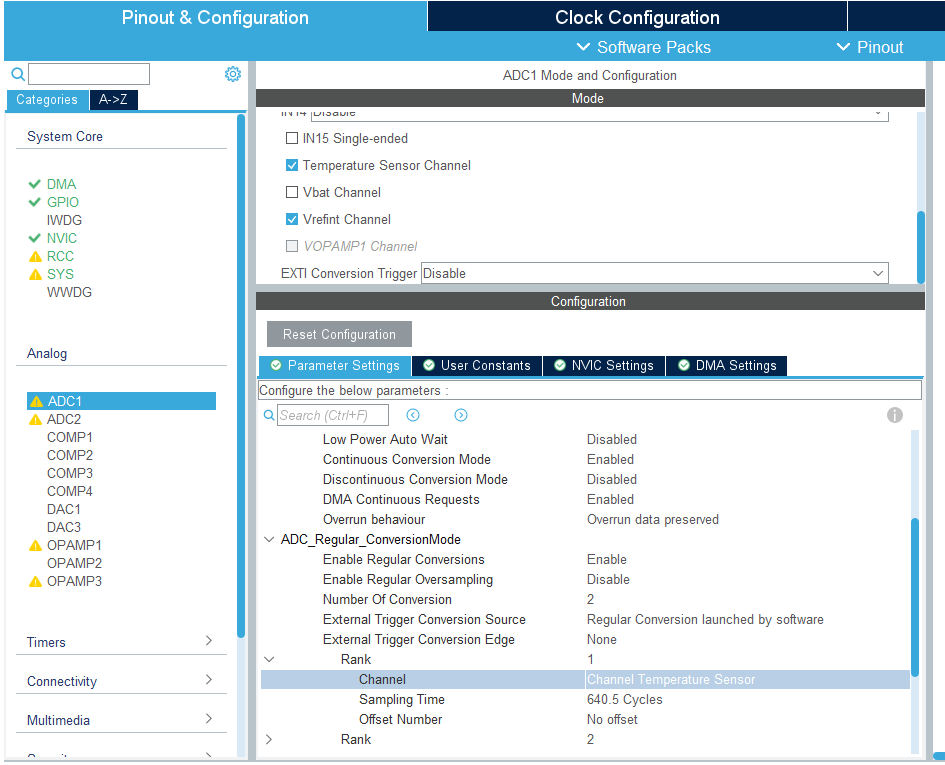

The configuration is default.
This is how I start the conversation
  HAL_ADCEx_Calibration_Start(&hadc1, ADC_SINGLE_ENDED);
  // Start the ADC in DMA mode
  HAL_ADC_Start_DMA(&hadc1, (uint32_t*) g_ADC_values, ADC_BUFFER_LENGTH);

What is the stack trace when the hard fault happens? What code is causing it to hard fault?
The random code, it depends when ADC triggers the DMA
I can't make sense of this answer.
Using DMA doesn't cause a hard fault in itself. It's possible the DMA is misconfigured, or trying to write somewhere it cannot. Look for the reason it's hard faulting and go from there.
