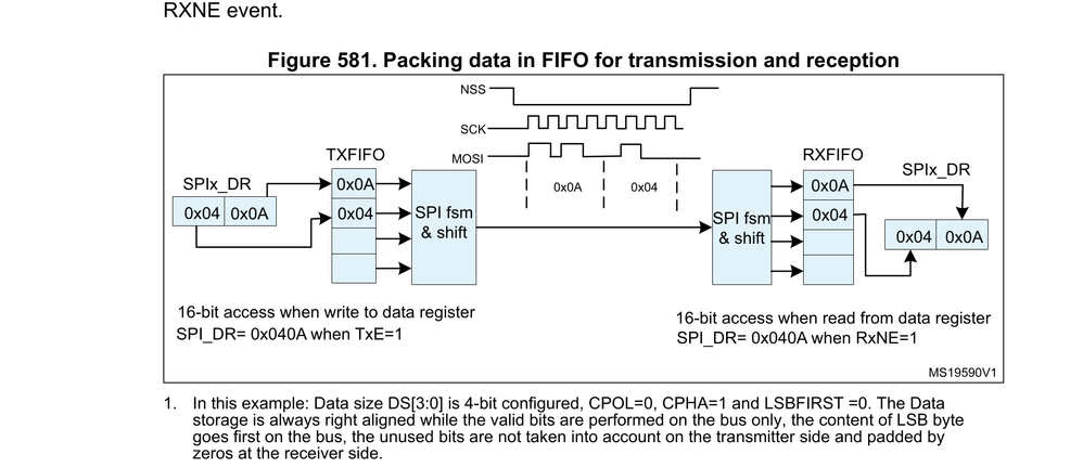

In principle, I already understand the reason for this behavior. When bytes are transmitted in 16-bit mode, the first byte transmitted is the most significant byte of the word, followed by the least significant byte. Consequently, the DMA reads the 16-bit number regardless of how the data arrived from the sensor and writes it to memory.
As a result, when reading the data array from the sensor's buffer, for example:
11 22 33 44 55 66 77 00
The DMA ends up writing to memory:
22 11 44 33 66 55 00 77
And it seems there is no simple and elegant solution in 16-bit format. Either I haven't found a way for the DMA to swap the most significant and least significant bytes on the fly, or it only allows assembling this array in a loop afterward.
I might have to revert to the 8-bit format.
