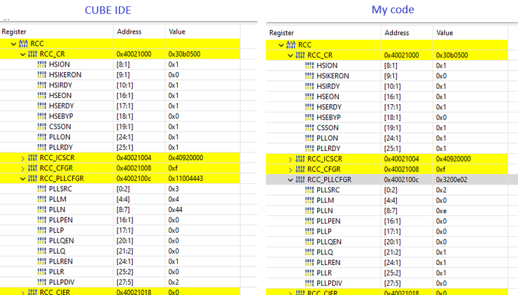

I have been working on a self learning project with STM32G431 controller. I am having trouble switching on the PLL to get 170MHz.
When I use the CubeIDE, I get the 170MHz clock.
Given below is my code on how I am trying to Initialize the PLL

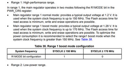

I believe the programming sequence may not be optimal or not inline with the Reference Manual recommendations
For example this code :
RCC->PLLCFGR = 0x00000000;
STM32G4 series advanced Arm<Sup>®</Sup>-based 32-bit MCUs - Reference manual
Bit 15 Reserved, must be kept at reset value.
See Page 291. also we need to follow the sequence of 6.1.5 Dynamic voltage scaling management
You can also debug and make a comparison on the assembly sequence from CubeIDE/MX .
Hope it helps you
