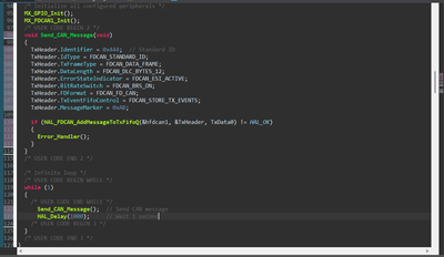

@mƎALLEm Didn't work but found something the the program freezes whenever I connect my USB To CAN analyzer. if not it is sending the DATA 3 times and then freezes maybe the TxFifo is getting filled
I have attached my main code other than that everything is from your setup. Thank you
int main(void)
/* USER CODE BEGIN 1 */
/* USER CODE END 1 */
HAL_Init();
/* USER CODE BEGIN Init */
/* USER CODE END Init */
SystemClock_Config();
/* USER CODE BEGIN SysInit */
/* USER CODE END SysInit */
MX_GPIO_Init();
MX_FDCAN1_Init();
/* USER CODE BEGIN 2 */
HAL_GPIO_WritePin(GPIOC, GPIO_PIN_13, GPIO_PIN_RESET);
void Send_CAN_Message(void)
TxHeader.Identifier = 0x444; // Standard ID
TxHeader.IdType = FDCAN_STANDARD_ID;
TxHeader.TxFrameType = FDCAN_DATA_FRAME;
TxHeader.DataLength = FDCAN_DLC_BYTES_12;
TxHeader.ErrorStateIndicator = FDCAN_ESI_ACTIVE;
TxHeader.BitRateSwitch = FDCAN_BRS_ON;
TxHeader.FDFormat = FDCAN_FD_CAN;
TxHeader.TxEventFifoControl = FDCAN_STORE_TX_EVENTS;
TxHeader.MessageMarker = 0xAB;
if (HAL_FDCAN_AddMessageToTxFifoQ(&hfdcan1, &TxHeader, TxData0) != HAL_OK)
Error_Handler();
/* USER CODE END 2 */
/* Infinite loop */
/* USER CODE BEGIN WHILE */
while (1)
/* USER CODE END WHILE */
/* USER CODE BEGIN 3 */
Send_CAN_Message(); // Send CAN message
HAL_Delay(1000); // Wait 1 second
HAL_GPIO_WritePin(GPIOA, GPIO_PIN_3, GPIO_PIN_RESET);
HAL_Delay(1000);
HAL_GPIO_WritePin(GPIOA, GPIO_PIN_3, GPIO_PIN_SET);
HAL_Delay(1000);
/* USER CODE END 3 */
