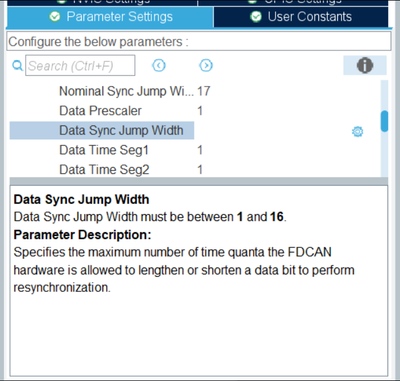

Yeah i used the Kvaser CANFD bit time tool but the values generated for the dataprescaler was not in the range
The DataSyncJumpWidth value is coming as 63
As for the bitrates The Nominal bitrate is 500 000bit/s and Data bitrate is 1000 000bit/s

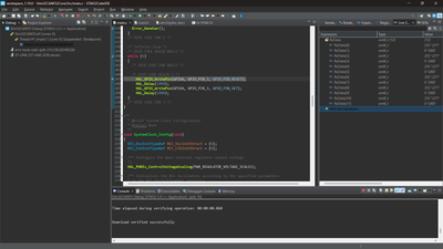

Thank you for your time. I will test this code and let you know. i saw your code to know it is working i just need to see the if the data from TxData is copied to the RxData in the debug console right?
2025-07-16 6:32 AM - edited 2025-07-16 6:34 AM
I didn't test with the debug console. BufferCmp8b() was used for data comparison Rx vs Tx.
Put two break points:
1- One at Error_Handler() (line 194 ) -> comparison failed -> communication failed
2- One at while(1) (line 200) -> comparison succeeded -> communication succeeded
PS: the attached project is based on this example: https://github.com/STMicroelectronics/STM32CubeG4/tree/master/Projects/STM32G474E-EVAL1/Examples/FDCAN/FDCAN_Loopback
2025-07-16 9:33 AM - edited 2025-07-16 9:43 AM
Seems it worked i guess the program entered the while loop also i can see the last TxData inside the Rxdata
Edit: So I have a doubt, is this check independent of my transceiver? Does it just verify that the STM32 is working and cannot verify that my transceiver is working, or does it verify that too?

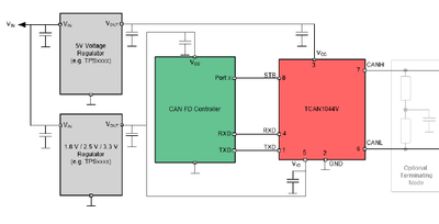

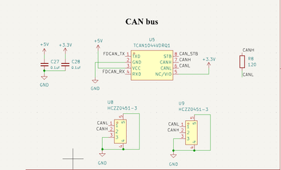

1- For Normal mode did you follow the schematic provided in the transceiver datasheet?
2 - What about both power supplies VCC and VIO? please check the power supply:
3 - What about the STB (Standby mode) voltage level? tied to GND? please do a continuity test with the tranceiver powred off.

Yep i followed all the thing is the datasheet.
I connected the STB to a GPIO (PC13) to the STM32 and pulled it low programmatically.
*** I'm sorry seeing now i haven't given the +5v it comes from the main supply through a buck and I've been giving only +3.3v from the STlink.
Can i now just change the mode to Normal Mode and keep everything else same and check again will you think it will work?
And yes i have a termination resistor in my STM32 board and one in my USB to CAN analyzer as well

1- You need to poser supply the tranceiver as following VCC=5V, VIO=3.3V
2- To me the schematic is OK. You need to ensure that STB pin is tied to the ground either externally or with a GPIO pin.
