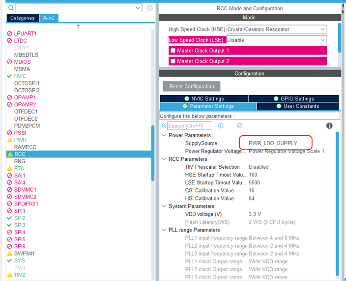

2) You have to tell the MCU that You want to use the LDO supply by setting PowerSource to PWR_LDO_SUPPLY under RCC ( I know, not very intuitive).

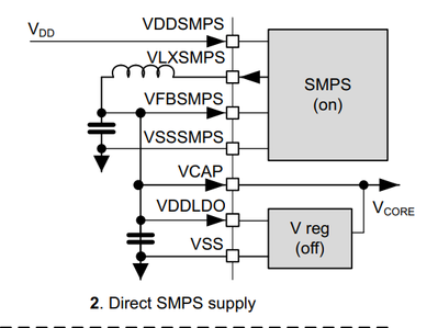

If so, this is the hardware required for the direct SMPS (RM0399 rev4/Figure 22):
In that case, VDDLDO is connected to VFBSMPS and not to VDD.
So please check all that hardware section.
Hope that helps.

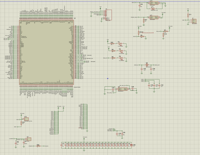

This is my full schametic of the MCU

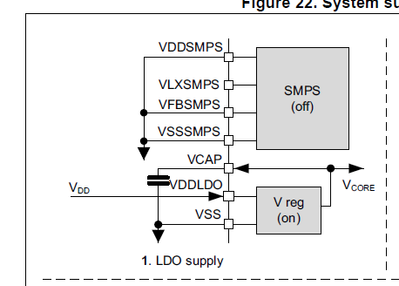

If You want to use the "simple" LDO supply mode, You have to connect VDDSMPS and VFBSMPS to GND.
Any thing else can damage the MCU.
This solution is working. I believe the issue was caused by an incorrect configuration in CubeMX, which triggered the MCU to enter protection mode.
