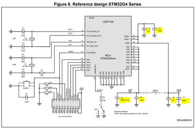

> Admittedly I do not have any 100nF Caps on there, as I tend to find them superfluous. Is that enough to upset thing that I'm seeing the issue Is have?
That's what my money is on.
Have you looked at 3V3 during startup on an oscilloscope? Might see a spike that would explain things. No way it's rock solid. A DC-DC converter and no decoupling or bulk caps (beyond 2x22uF) certainly goes against hardware recommendations.
I understand they're inconvenient, but if they weren't necessary, they wouldn't be recommended. You can get away with using less, but probably not none.
If you could replace that with an LDO (at least temporarily), might also be worth checking. LDO shouldn't be as prone to spikes.

I admit it does look like some sort of PSU issue. I'm on the 2nd design and changed my DC-DC to this one which I have used lots in the past. I have scoped it during power up, and all the time whilst monitoring the failure, and it seems to be rock solid - no overshoots etc. The only time it struggled was when the G4 decided to go short circuit. I will mount the recommended 100nF and perhaps power form and external PSU as you suggest. May go quiet for a few days whilst I re-build.

Unless it breaks the specs of the power source, there cannot be enough capacitors, for stability, noise, EMI, ...
Come on, a controller powering up with 160 MHz, that might be enough to get a supply spike to reset.
