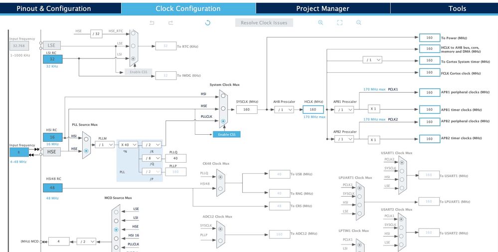

I am having some strange power up (I think) issue with my STM32G431 controller. Sometimes it runs for a second or two, sometimes nothing. It will usually not connect via the SWDIO pins so it is difficult to step through in debug to see where the problem is. I'm suspecting a problem with the clock configuration, SWDIO pins not defaulting to their proper state, or Reset pin problem. None of which I can put my finger on. I am used to STM32F4, H7, this is the first time I have used the G4, so willing to accept the problem is on my side! Any help or pointer appreciated. I use CubeIDE to configure the clock and generate all of the initialisation code, via the .ioc file.

I just had a look at your clock settings and compared to an old Nucleo G431 project.
- why PWR_REGULATOR_VOLTAGE_SCALE1_BOOST ?
- your PLL multiplier N = 40 might be too high, assuming your crystal is > 8 MHz, so what's the X1 frequency?

I believe the clock configuration is ok. I set it up in CubeIDE. Usually it will have a hissy fit if something is incorrect.
Exact Resonator is a Murate CSTNE8 8 MHz Ceramic Resonator. I have used it on many other ST devices without issue.

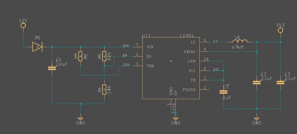

You never answered the question about bypass and bulk capacitors. Are they present on the board? How exactly is this being powered? What is generating the 3V3?

A ceramic resonator, interesting. That really much better than the HSI?
Anyway, with 8 MHz that's seemingly not the problem then.

Here is my PSU from 12V to 3V3. Admittedly I do not have any 100nF Caps on there, as I tend to find them superfluous. Is that enough to upset thing that I'm seeing the issue Is have?
