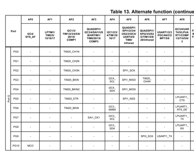

I suspect that having no alternate function set in AFR\L registers is what is not correctly set, but I don't see the mapping table mentioned in the reference manual: "Refer to the “Alternate function mapping” table in the device datasheet for the detailed mapping of the alternate function I/O pins."
What should these registers be set to for MCO and where is the mapping table?
So did you? The datasheet is a separate document from the reference manual.
MCO is AF0, so 0 is correct in those registers.
Make sure output speed is very high.
2024-09-17 7:19 PM
Ahh...once again, datasheet and reference manual are different. So, yes...AF0 is correct.
