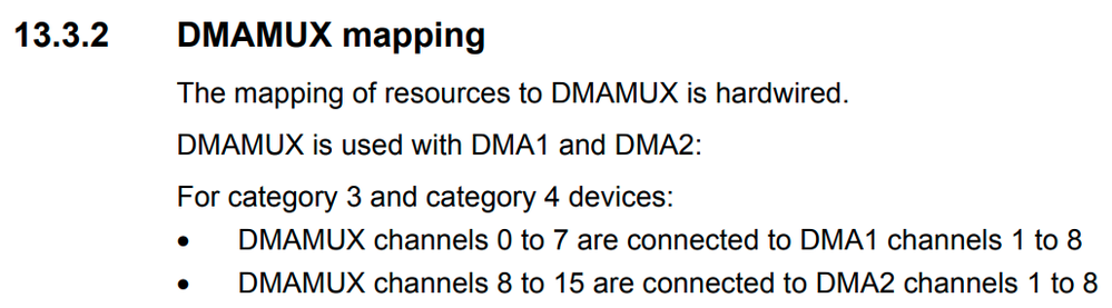

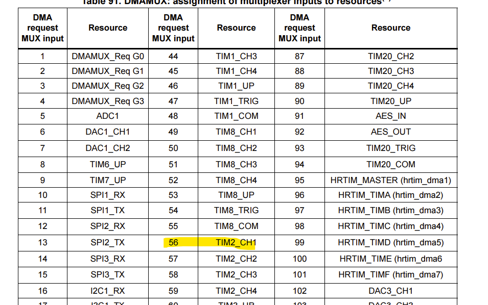

You can use any channel you want. You need to set up the MUX such that that channel's input is tied to the request that you want.
For example, if you want to use DMA1 channel 1, set DMAREQ_ID=56 in DMAMUX_C0CR.
If you want to use DMA2 channel 8, use DMAMUX_C15CR instead.
(Note that DMA channel indices are 1-based while DMAMUX indices are 0-based.)

Hi @TDK
Now I see, The register I write sets the DMA channel: DMAMUX_C0CR refers to DMA1channel1, DMAMUX_C1CR refers to DMA1channel2, and so forth.

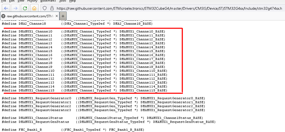

2022-04-27 4:52 AM

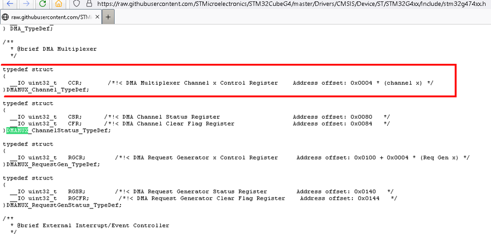

ST is not very consistent in keeping RM nomenclature en sync with symbols in CMSIS-mandated device headers. As ST declines to provide normal examples, sometimes you may be required to have a look at the header yourself:
i.e. you'd use DMAMUX1_Channel0->CCR = 56;

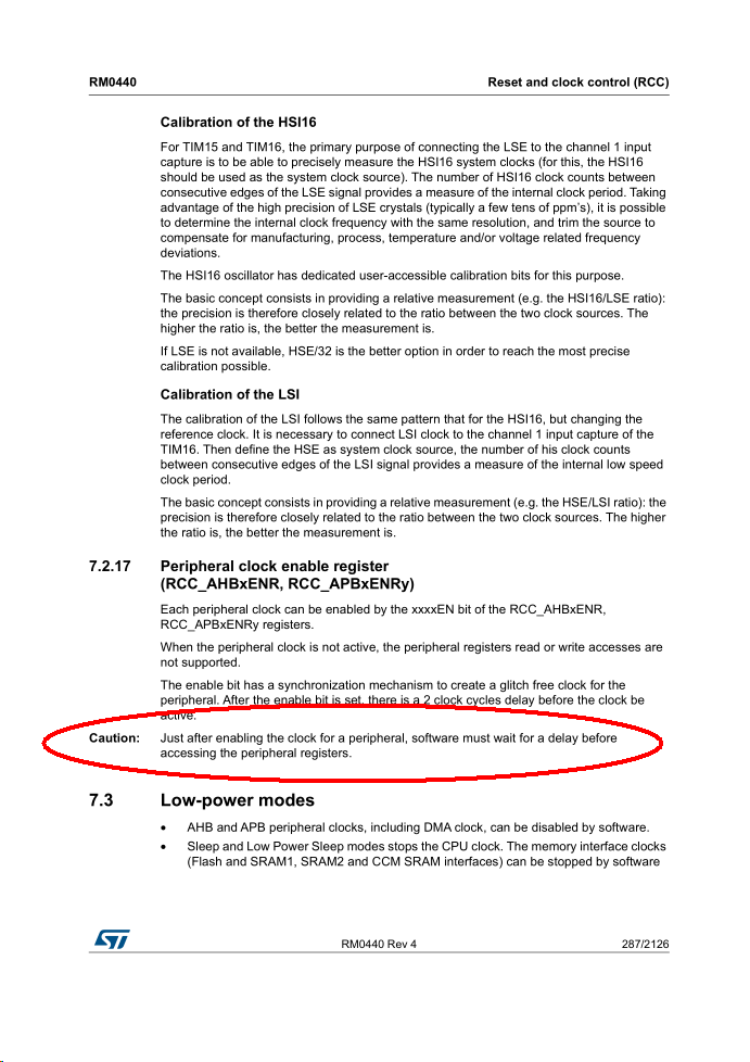

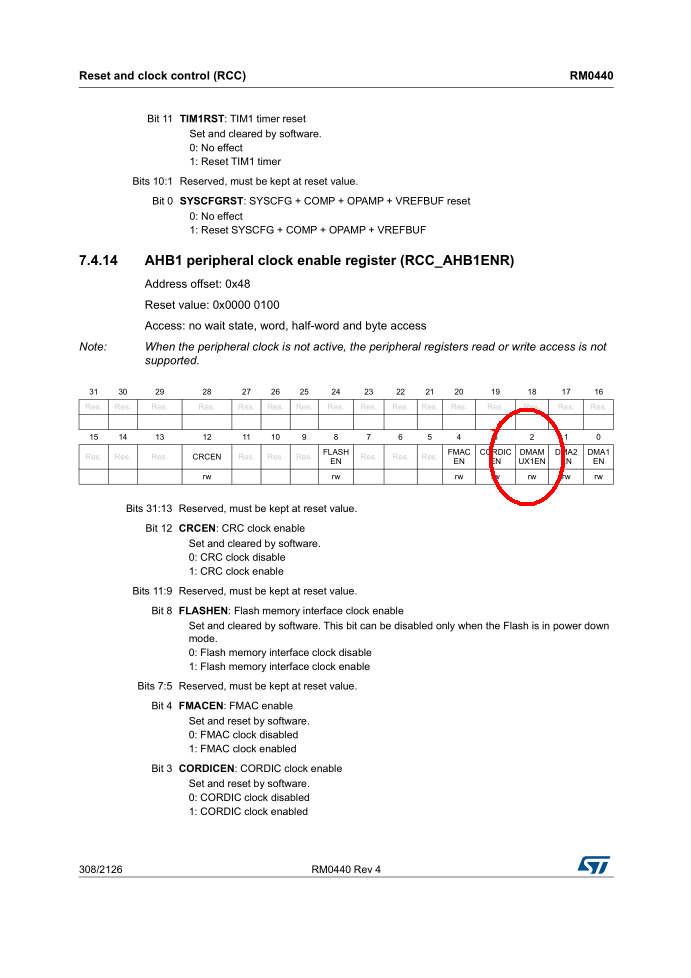

I bet you can't as you probably did not enable DMAMUX clock in RCC:

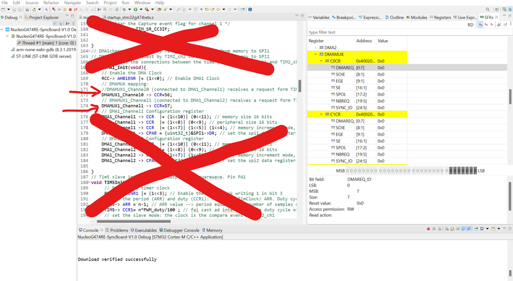

2022-05-06 3:25 AM
Hi @Community member
yes I forgot to enable the DMAMUX clock in the RCC.
As you explained, now I can edit the register in the debugger and that works.
However with my code (relevant part reported below) the registers still do not change.
Do you have any idea about this latter issue?
void DMA1_Init(void){
// Enable the DMA Clock
RCC-> AHB1ENR |= (1<<0)|(1<<2); // Enable DMA1 and DMAMUX1 Clock
// DMAMUX mapping:
//DMAMUX1_Channel0 (connected to DMA1_Channel1) receives a request form TIM2_Ch1.
DMAMUX1_Channel0 -> CCR = 56;
// DMAMUX1_Channel1 (connected to DMA1_Channel2) receives a request form TIM2_Ch2
DMAMUX1_Channel1 -> CCR=57;
