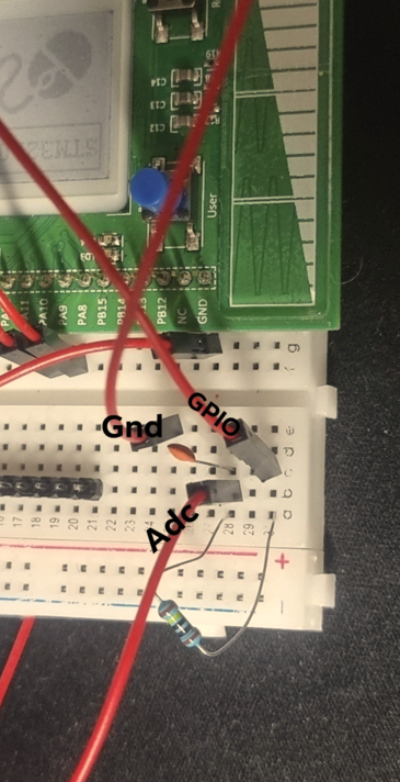

I'm trying to measure capacitance with my STM32L053-Disco
I'm using ADC and one output pin to charge the capacitor. I tried measuring time it takes for capacitor to charge to 62.3%.
The problem that I'm facing is that the values that I'm getting from ADC never show that it gets any charge.
I use 1 nF capacitor and 1MOhm resistor
This is my circuit:

I never get to measuring capacitance because these are the ADC values that I get:
Can anybody help me?

2022-05-10 5:55 AM
On the basis that your ADC is working you should be able to get an approximate value.
Looking at your code, your loop is running slow. The rise time of your 1MOhm / 1nF will be a couple of milliseconds. You have a 100millisecond delay plus uart tx in the loop. If you tighten your loop and dump samples into buffer, do you see voltage across capacitor rising?
