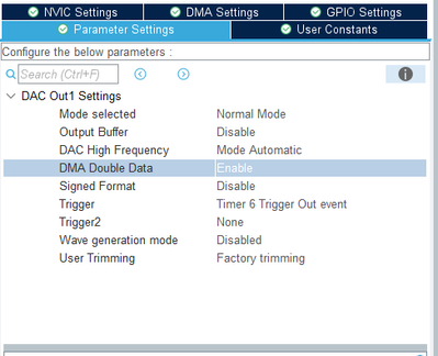

DAC settings (DMA double data enabled):

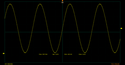

Sine wave generated when DMA double data is disabled:

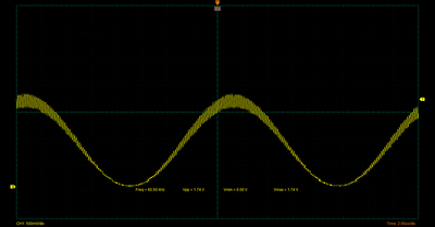

Sine wave generated when DMA double data is enabled:

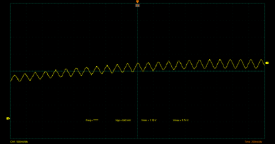

'Close-up' of the superimposed signal:
From this image the superimposed signal frequency seems to be ~6.17 MHz.
