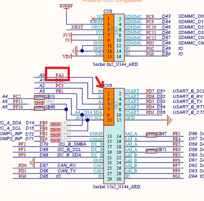

Do you confirm you are using STM32H723 NUCLEO board? PA3 is on CN9/pin 1:

Are you using CN9/pin 1 as EXTI input? PA3 to be connected to GND to trigger the EXTI interrupt.
At this stage, you need to check if the IO is not broken. Could you please try to toggle that PA3 pin?
