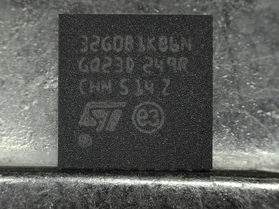

Hi @XD ,
I have a request: as you probably are going to get the proper N-suffixed parts, once you get them, could you please post photo of them here, for others to have a reference?
Thanks,
2026-02-05 5:27 AM
@waclawek.jan, I've ordered a few of DigiKey to attempt swap the wrong one out. I should get some next week, and ill order a new set of boards but they'll arrive at least 6 weeks from now.
May I ask why you need photos of the IC markings?
To detect counterfeits?
Long story short:
I contacted the fab and they apologized and claimed that the N-variant was simply for the extended temperature range. A bit of back and forth with pictures and links to the datasheet pointing out that they were wrong. They did eventually offer to refund the order since it was a handful of simple prototype boards.
2026-02-05 8:21 AM
Not me personally.
It would benefit anybody who comes across the same problem as you in the future.
The point is to highlight the differences in the marking. I know, the marking changes, but generally, the differences should hopefully stay roughly the same.

2026-02-10 2:37 AM
Thanks.
OK so they omitted the "package type" letter (U) to fit in the "extra" "N".
That's not exactly expected and IMO this ought to be documented in the DS and/or TN1433, preferrably both.
> it never crossed my mind that the fab would place the incorrect processor
While the fab is guilty too, placing a vital part of the marking beyond the "lesser" (memory size, package type and temperature range) is IMO a major mistake on ST's part. Would I be responsible for such decision, I would make the disctinction directly in the package digits/letters (i.e. here "KxU" may be well changed for e.g. "KxV" or something along those lines) but maybe I would even go as far as highlighting the disctinction by changing the last digit/letter in the "principial" part of the marking (i.e. here I'd use STM32G0B2 or STM32G0BA or similar). I would avoid *adding* suffixes to *functionally different* parts at all costs.
The same goes for the "SMPS" variants (suffixes P, Q).

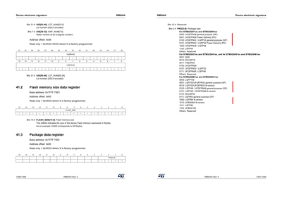

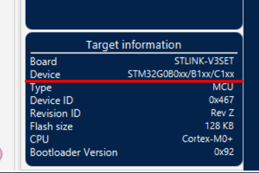

PS. Once one knows what to look for, the distinction between non-suffixed and N-suffixed part can be found out also by reading the device's signature, maybe even CubeProgrammer supports this?
The mess this issue is can be seen also in how the suffixed/non-suffixed disctinction is marked as "Power Delivery" and "N-version" in various models, within the same page. ST, it's you who invent the nomenclature, please strive for consistency.

I've also experienced lackluster documentation, especially from the HAL or other tools.
I quickly tried to read the Package data register from CubeProgrammer but I can't seem to read any register below 0xE000ED04.
It would be a nice feature to add to CubeProgrammer since one of the first things I looked for was the device ID and type. I don't think that there is a way to know exactly what variant is used (other than looking at the UUID and referencing a database). At least they could add the Device electronic signature register to the register menu.
