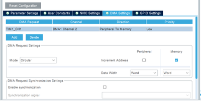

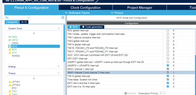

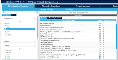

Hi thanks for the reply i understood your point and i have made changes since i have commented out the irq handler and i will be waiting in the polling method for the new data available once new data available i need to process as quickly as possible so will the below things are correct
So we need a capture in dma method only and i need to process as soon as possible
i need to reduce the overhead for calling interrupt callback and then process the freq
// Disable DMA IRQ to prevent interrupt processing
HAL_NVIC_DisableIRQ(DMA1_Channel2_3_IRQn);
// Disable DMA transfer complete interrupt
__HAL_DMA_DISABLE_IT(htim1.hdma[TIM_DMA_ID_CC1], DMA_IT_TC);
// Clear any pending DMA flags
__HAL_DMA_CLEAR_FLAG(htim1.hdma[TIM_DMA_ID_CC1], DMA_FLAG_TC2 | DMA_FLAG_HT2);
// Start DMA in circular mode (runs continuously)
if (HAL_TIM_IC_Start_DMA(&htim1, TIM_CHANNEL_1, (uint32_t *)captr_pwm, CAPTR_SAMPLE_COUNT) != HAL_OK)
printf("TIM1 IC Start Error\n\r");
static inline uint32_t captr_pulse_freq(void)
// Early exit if data not ready
if (!(DMA1->ISR & DMA_ISR_TCIF2)) return 0;
// Clear flag
DMA1->IFCR = DMA_IFCR_CTCIF2;
//process the freq
void DMA1_Channel2_3_IRQHandler(void)
/* USER CODE BEGIN DMA1_Channel2_3_IRQn 0 */
/* USER CODE END DMA1_Channel2_3_IRQn 0 */
// HAL_DMA_IRQHandler(&hdma_tim1_ch1);
/* USER CODE BEGIN DMA1_Channel2_3_IRQn 1 */
/* USER CODE END DMA1_Channel2_3_IRQn 1 */

DMA flags need to be checked and handed within the IRQ handler, otherwise it will continuously re-trigger. Interrupts are enabled within HAL_TIM_IC_Start_DMA. You can disable interrupts after calling that, and wrap it all within a __disable_irq/__enable_irq, if you don't want interrupts to be called.
