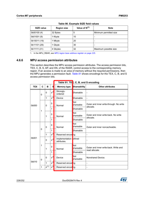

Per AN4839, the 0x60000000-0x7FFFFFFF range on STM32H7 is "normal memory", cacheable. What you see could be loading the 32-byte cache line and write back.

Do you have that area set as Device or as Memory in MPU?

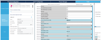

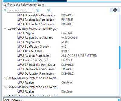

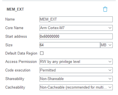

2025-06-18 1:04 PM - edited 2025-06-18 1:17 PM
Either I don't know where to search for this option, either it did not exist xD :
Edit :
I also try to deactivate the MPU without success, I still have 4 write cycle.
2025-06-18 10:27 PM

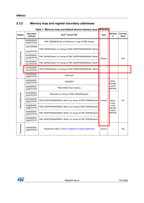

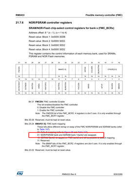

I don't know which 'H7 you are using, so I looked into RM0433 (for 'H743 and kin) and there's an option to remap the SRAM/NOR area of FMC to a different address, which is by default set to Device:
The remap in the 'H743 is accomplished through setting the FMC_BCR1.BMAP bitfield
However, if you apply MPU settings onto a memory area, its those MPU settings which override the defaults, so here you would perhaps want to do only the remap without using MPU at all.
