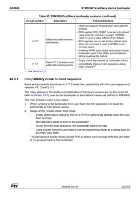

Dear @Igor80 ,
You can refer to this update on the bootloader versions https://www.st.com/resource/en/application_note/cd00167594-stm32-microcontroller-system-memory-boot-mode-stmicroelectronics.pdf#page223
Hope it helps,
STOne-32
