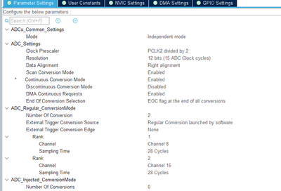

DMA screenshot show word, but ADC results is HALF WORD. And you dont show haw and where you create array for adc values.

Showing schematics could help. Does the voltage divider have sufficient low impedance? Increase sampling time to the max. Is VDDA stable? You could measure internal VREFINT channel for reference.
hth
