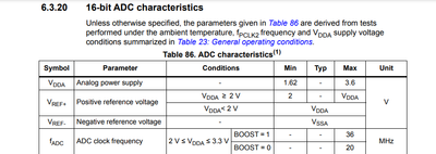

RongShengWang
Associate III
 The datasheets (STM32H753ZI) says (P173) - "the VREF s available only on UFBGA176+25 and
TFBGA240+25"
It shows the negative input exists in UFBGA176+25 and TFBGA240+25" .
It contradicts what your reply. Could you ask ST Support?
Thanks,

As you said, I need ST support engineer to answer my question - Please let ST support engineer to answer my question
TFBGA240+25"
It shows the negative input exists in UFBGA176+25 and TFBGA240+25 packages" .
 Also the reference manual says -
      "In differential input mode, the analog voltage to be converted for channel “i” is the difference
between the external voltage VINP[i] (positive input) and VINN[i] (negative input").
    "In single-ended input mode, the analog voltage to be converted for channel “i” is the difference between the external voltage VINP[i] (positive input) and VREF- (negative input)." - however VREF- is a fixed value.
      In the differential mode, it does allow the negative inputs.
