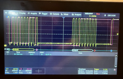

However, all longer commands are failing. Here is a capture and protocol decode (with my annotations) of the "GET" command (command 0), The first 2 bytes of response is corect, however everything following that is 0x1F

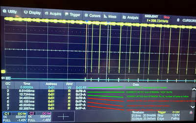

Here's a zoom-on of the first 0x1F response:

Ok, I have found the issue: I was reading every response byte as a new frame... If I read the rest of the bytes after byte#1this command works.
#get
i2ctransfer -f -y 2 w2@0x51 0x00 0xff #write command
i2ctransfer -f -y 2 r1@0x51 #read ACK
i2ctransfer -f -y 2 r20@0x51 #read the rest of the bytes, must be one frame
