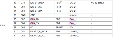

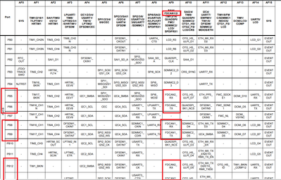

1- In the manual gives you an example of CAN pin usage (PD0 and PPD1) and it's not a restriction:
To find the CAN pin usage possibilities the datasheet is the right document to refer to:
Many possibilities for FDCAN1 and FDCAN2 offer to you (make a search in the document). But you need to select a pin not used in the board i.e. it's a free pin and not connected to nothing else in the schematics.

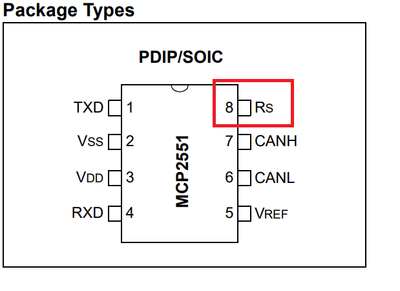

2- And this transceiver pin needs to be pulled to the ground:
I see from your screen shot you are using shields but better to double check with a multimeter (in continuity mode with transceivers are powered off).

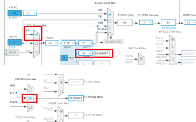

To me, I have a doubt regarding the bitrate:
Are you sure this is the intended CAN bitrate? 115440 ? this is not a regular CAN bitrate.
if yes do you have the same bitrate on both CAN nodes?
Also, it's not recommended to use HSI for CAN communication. You need an external precise clock either a crystal or crystal oscillator:

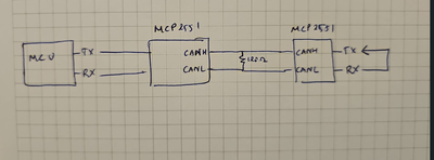

Just a small query, this project is to test the CAN communication. Is it possible to do this with one board and 2 transceiver ( loopbacking TX and RX of the second transceiver so that whatever data you transmit is getting received ) ?

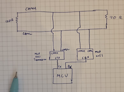

its a hand-drawn schematic.
2025-01-06 10:57 PM
Yes you can use 1 Nucleo that has at least 2 CAN controllers. You can't loop the TX and RX on the CAN transceiver. Technically you need two 120 ohm resistors on either ends of the CAN bus lines.

Hello;
No this is not the right HW connection:
@Aswin wrote:
Here you connected two transceivers to the same CAN instance. You need two CAN/FDCAN instances for example CAN1 and CAN2 and two transceivers. For both MCUs you have two CAN instances each.
This is the minimum hardware and connection to establish between two CAN nodes:
You can use two CAN instances of the same board.
You didn't attach your two projects for both boards and you didn't tell if you changed the clock source from HSI to HSE.
As you are using Nucleo board, you can read this article how to use STLINK MCO as a precise clock source for CAN.
