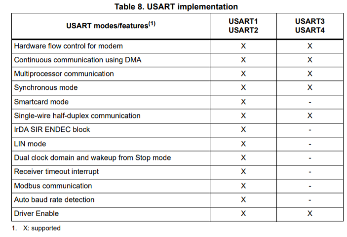

I have 2 MODBUS 485 ports, one in UART1, the another in UART3, both in DMA mode.
Testing frame collisions with Docklight I see the function HAL_UART_ErrorCallback called with an Error code of 1 (Parity error), 8(Overrin error) or 11 (Parity+Noise+Overrun error).
In case of UART1, after a restart it recover himself and continue communicating without any problem.
However, when UART3 crashes (same type of messages, same frame collisions) after the same code, the UART doesn't recover, and I have to reset the microcontroller.
I saw in the datasheet the next table; (page 27 of https://www.st.com/resource/en/datasheet/stm32g070cb.pdf)
There are some differences between UARTs, maybe I have to add more code for reset the UART3.

2021-03-14 7:34 AM
HAL drivers are not interrupt/thread safe and overall broken and bloated. Just an example:
Drop that junk and implement something sane:
