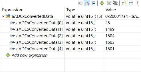

I configured ADC with DMA for 5 channels.
but converted values are wrong. Last channel value stored in First in the buffer and
First channel value copied to remaining buffer

}what could be wrong ? Value 25 should be in Last value in the buffer.
third to fifth values are copied from second channel.
When I configure only one channel then Conversion is ok.
