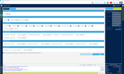

Unfortunately there is no DBG_APB_FZ1 register in OB tab.
