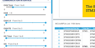

STM32CubeMX can be used to filter chips by the available peripherals.
There are 1164 chips with 1 or more CAN buses. For example, most chips in the H7 and H5 series. The STM32H723ZG could be used.
You will need to use a CAN transceiver chip.
