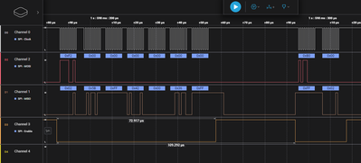

That what I see with analizer, ADXL345 responds correctly, yet without the extra code of the reading DR In the start of transaction, before toggling NSS pin, I get one or two trash bytes.
(void)CAST_IO16(pBus->DR); (void)CAST_IO16(pBus->DR);
I don't use either BIDIR or RXONLY, as I wrote I also tried it, but in this mode after switching to normal mode SPI transmits extra byte with cleared 7th bit (for ADXL345 it's register address), and it's a problem cause ADXL345 determine it like a writing procedure to register, so I got my solution broken.

So, in you waveform above, you've read from SPI_DR 7 bytes in the first transaction during NSS being low, yet you've found one or two more bytes in it before NSS went down the next time? Or how should that waveform be interpreted? It would be helpful if you'd toggle a GPIO pin at the moment of reading from SPI_DR, and observe that on the LA, too.

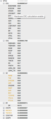

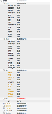

Read out and post content of SPI registers just *before* you'd read the dummy bytes.
2023-12-01 2:20 AM
Before reading DR while NSS is High
After (NSS is LOW)
Totaly the same, but if I don't read DR twice I'll get dummy bytes. And as I said before I used the SPI librarry for years for f0 mcu, and had no issues.
