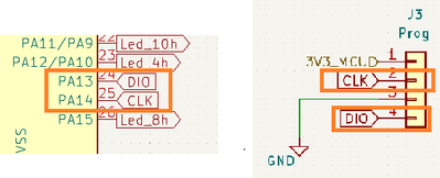

Today the debug pins are direct connection (without any pull-up or down), as show:
But I already tried to pull-down (and pull-up) the SWCLK pin (as shared with BOOT0). but no way to recognize te MCU.
Any idea? I just want to flash my first code into this G030

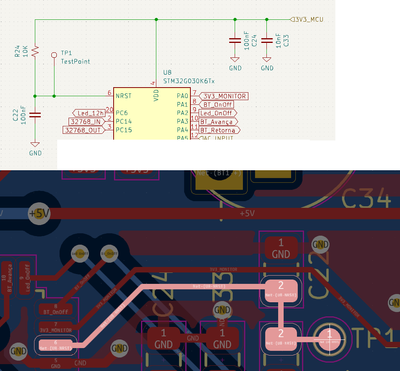

2023-10-05 12:20 PM
HW and SCH OK, i mean, the design it's OK (image below)
for sure, i have investigating another variant things, such as solder and now, the MCU origin (from suspicious vendor)
O, yes, the existence of R24 totally confirms it. Edited by moderators to adhere to community guidelines.
2023-10-05 12:54 PM
sorry i did not understood u.. this is my practice to use pull-up (if need it, i saw that G030 did not require but i design anyway) on NRST... what do u mean?
