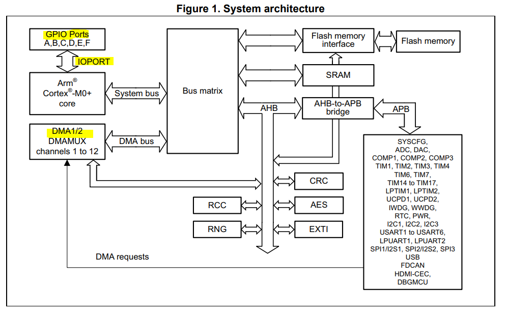

I can only see both the GIF and TEIF flags in the DMA ISR register set, implying the transfer error. With the DMA CNDTR remains unchanged. Meaning that the transfer error happens at the 1st data transfer (from memory to GP!OA BSRR).
Note: If I change the destination as memory and do memory to memory transfer, the code works.
But looking from the reference manual - RM0454 section 2, the diagram shows GPIO port bus and DMA bus may not be "connected".

Indeed - the 'G0 (as well as 'L0) is Cortex-M0+ which has a special port on the processor for GPIO, so you can't DMA onto GPIOs.

Read more here: https://www.st.com/resource/en/product_training/STM32G0-System-General-purpose-IO-interface-GPIO.pdf
"I/O ports are directly connected to the single-cycle IO port bus. This allows fast I/O pin operations, e.g. toggling of the pin every two clock cycles. No conflict with the DMA can occur because this Cortex®-M0+ port is private to the CPU."
