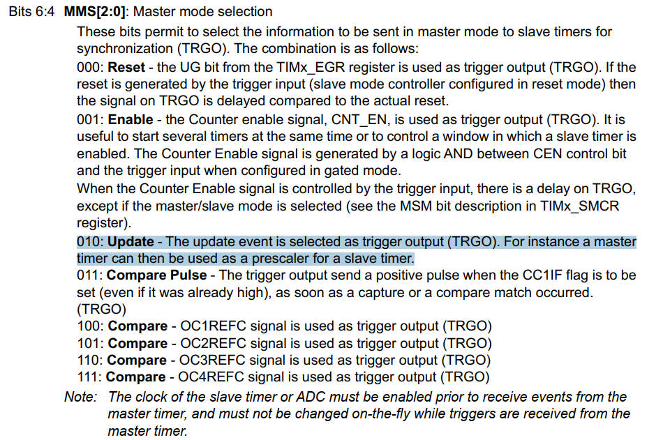

TIM3->CR2 = (2 << TIM_CR2_MMS_Pos); //010: Update - The update event is selected as trigger output (TRGO)does what you want ?

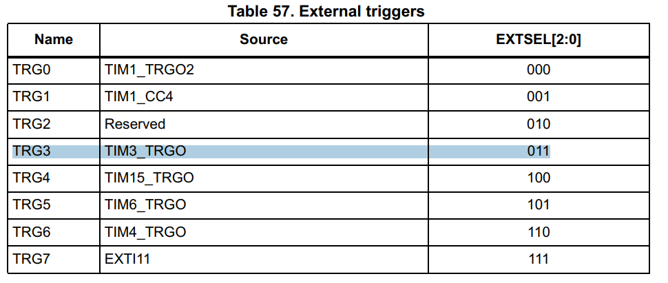

ADC1->CFGR1 |= (3 << ADC_CFGR1_EXTSEL_Pos); //TIM3_TRGOdoing what you want?

are you sure of
are you sure of
doing what you want?2022-11-26 10:11 AM

What if
TIM3->CR2 = (2 << TIM_CR2_MMS_Pos);is overwriting some other important stuff in CR2?
Im seeing now you dont use any
|=to set those bits
Or maybe youre trying to set the MMS in the wrong register, i dont really know, just trying to get some clues
