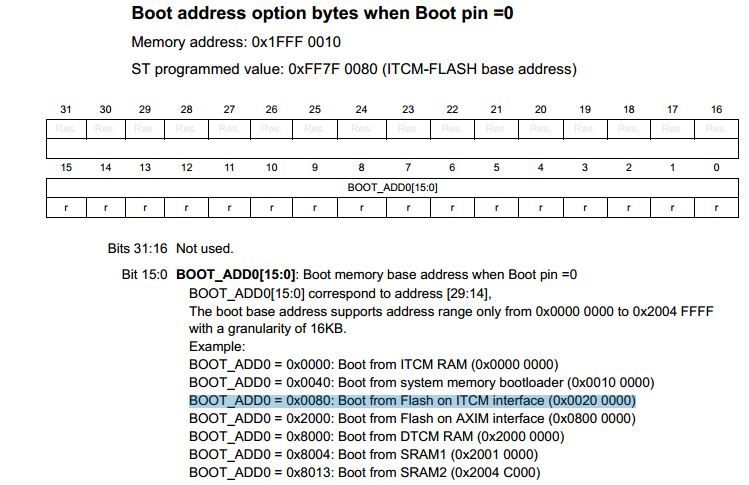

I am confused about the boot setting in STM32F7xx series.
When the boot pin is low, it boots from flash on ITCM interface (0x0020 000) by default, as shown in the screenshot of the manual.0x08000000,
for ITCM, ROM starts from0x00200000.
So the BOOT_ADD0 setting is not working? #stm32f7-axim-itcm-flash-interfac2016-03-28 10:21 AM

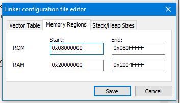

Hi ALL,
The way to choose AXIM or ITCM flash interface in IAR is to configure the ROM address in the linker file.For AXIM, ROM starts from0x08000000,
So the BOOT_ADD0 setting is not working?We’re moving the ST Community to a new platform to give you a better and more reliable community experience.
