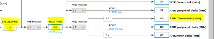

2017-10-16 10:58 AM
Thank you both for the analysis. I took the existing example for TIM3 from the STM32CubeF7 example project and verified the clock source for TIM3. In this case TIM3CLK = PCLK1*2 where PCLK1=HCLK/4. Using that information TIM3CLK = HCLK/2 = SystemCoreClock/2. For this target the SystemCoreClock is 216 MHz. As a result TIM3CLK is 108 MHz.
Is there something I'm missing? I've played with all sorts of permutations of the Prescaler and Period but can't seem to achieve the 1us period I need. I even found a clock calculator from Mikroelectronica. Their ARR and PSC values correspond with what I calculated (PSC = 0, ARR = 215) but I still don't have the right 1 us clock rate desired.

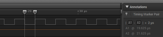

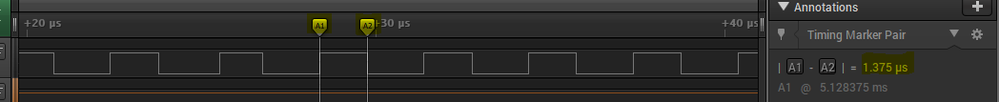

Hi Joerg,
Thank you for providing the report. I too was able to get a 2us pulse width, originally. My desire is to get a 1us resolution (ie pulse width). If this is not possible then is there an explanation for that? The best I can seem to do is this:
Many thanks for taking the time for your above analysis.

2017-10-17 2:25 PM
Hi Mehmooed, It is a 1us resolution!
When you toggle the state of a signal every 1us you will get the half of the frequency, 2us.
