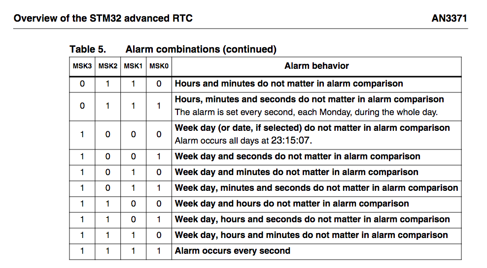

Thanks for reply
How can I define this mask combination? Can you give the code?

I don't use the SPL, I use the HAL. In the HAL its part of your alarm initialization struct. Probably in the SPL, too. Read the app note and look at how the alarm struct is defined in the header file you use.

I use this code for enabling alarm for every one second. but it does not call the RTC_IRQHandler()
static void RTC_AlarmConfig(void){// EXTI_InitTypeDef EXTI_InitStructure; RTC_AlarmTypeDef RTC_AlarmStructure;// NVIC_InitTypeDef NVIC_InitStructure;/* Enable the RTC Alarm Interrupt */ NVIC_InitStructure.NVIC_IRQChannel = RTC_IRQn; NVIC_InitStructure.NVIC_IRQChannelPriority = 0; NVIC_InitStructure.NVIC_IRQChannelCmd = ENABLE; NVIC_Init(&NVIC_InitStructure); /* Set the alarmA Masks */ RTC_AlarmStructure.RTC_AlarmMask = RTC_AlarmMask_All; RTC_SetAlarm(RTC_Format_BCD, RTC_Alarm_A, &RTC_AlarmStructure); RTC_AlarmSubSecondConfig(RTC_Alarm_A, 0x1, RTC_AlarmSubSecondMask_SS14);

Isn't there a specific 1 Hz interrupt, try doing an alarm at multiple seconds in the future.

I realize that I cant set the alarm .I think it is the reason that rtc interrupt dont trig. for example I set the below variable:
RTC_AlarmStructure.RTC_AlarmTime.RTC_Hours = 5;
RTC_AlarmStructure.RTC_AlarmTime.RTC_Minutes = 5;
RTC_AlarmStructure.RTC_AlarmTime.RTC_Seconds = 5;
But the returned values of them is zero.
Its my code for set time and alarm value.

How can I adjust alarm correctly?

I think you need to readAN3371
