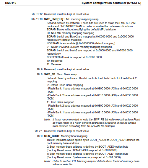

/******************************************************************************/And then I want to remap the SYSCFG memory remap register (SYSCFG_MEMRMP)
but there is no option to do at STM32F7xxxx :pouting_face:
This is the SYSCFG_MEMRMP
Why setting the Vector Table Offset Register is not enough and I have to remap hardware?
Why the SRAM remap option of STM32F4xxxx (see RM401 7.2.1) was removed at STM32F7xxx ?
Alle the core 210MHz speed is lost by 7 wait states for flash because on push and pop of IRQ the ITCM has to fetch twice the I-Cache with 7 wait states.
Looks like the STM32F7xxx is not an IRQ performer without any external RAM
Any ideas how to use this VIDEO RAM to execute IRQ handlers?
2019-05-29 9:24 AM
ITCMRAM is AT ZERO, you don't need to remap it. Both ITCM and DTCM RAM should permit instruction reads
The SCB->VTOR pointing to zero should point to the ITCMRAM, and functionality should be demonstrable.
