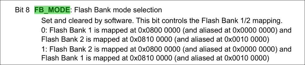

My understanding is that when setting BFB2, Bank 2 is remapped to 0x0800 0000.
Why should we need to set VTOR on reset if thanks to remapping it should interact the same?
Meaning I expect the start of my vector table for app2 to be at the same address as app1 since I have not modified it.

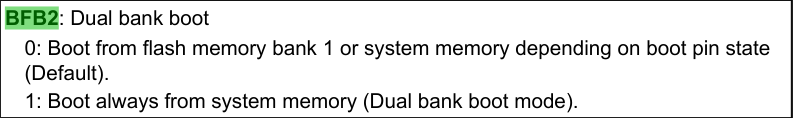

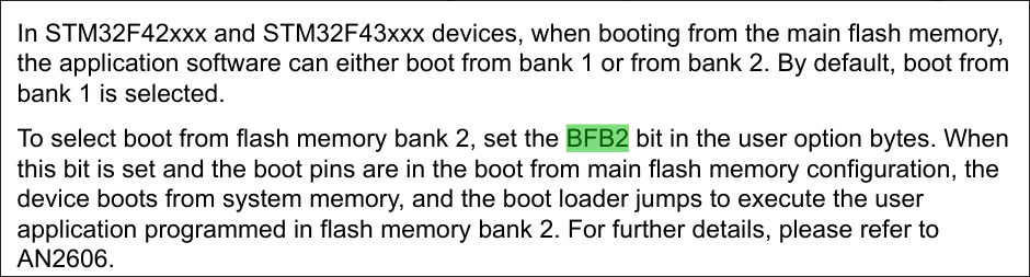

Setting BFB2 will force a boot from system memory according to RM0090.
It says that the system bootloader located there jumps to bank 2.
When the device boots after setting BFB2, FB_MODE is also set (I checked via the debugger). Indicating Flash Bank 2 is mapped at 0x0800 0000.
So what is the point of setting VTOR if its default value, 0x0000 0000, is the alias to Flash Bank 2.

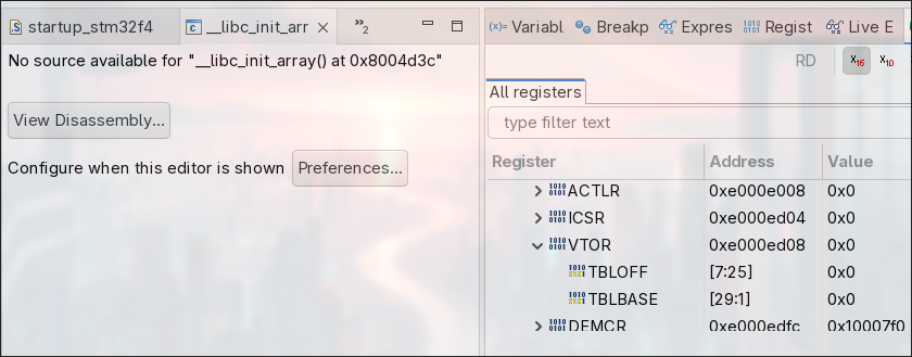

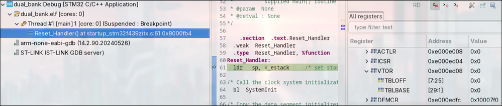

VTOR is set to 0 when I inspect it using the debugger at the reset handler and it stays that way as far as I can see.
The program reaches main and after jumping over MX_ETH_Init() I am brought back to the reset handler for some reason. I recall reading that the ethernet configuration messes with the same register as VTOR I think but I don't know if its related here.

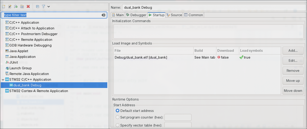

I programmed App 1 to 0x0800 0000 and App 2 to 0x08100 0000 using cubeprogrammer making sure the flash is not erased when programming.
Then I set BFB2 so that banks will be swapped and I boot from bank 2.
I then disable downloading of the flash application when running with the debugger like so:
I do get this when debugging as well :
Seems strange since the last compiled application is the one for bank 2 (the one I am running currently).
